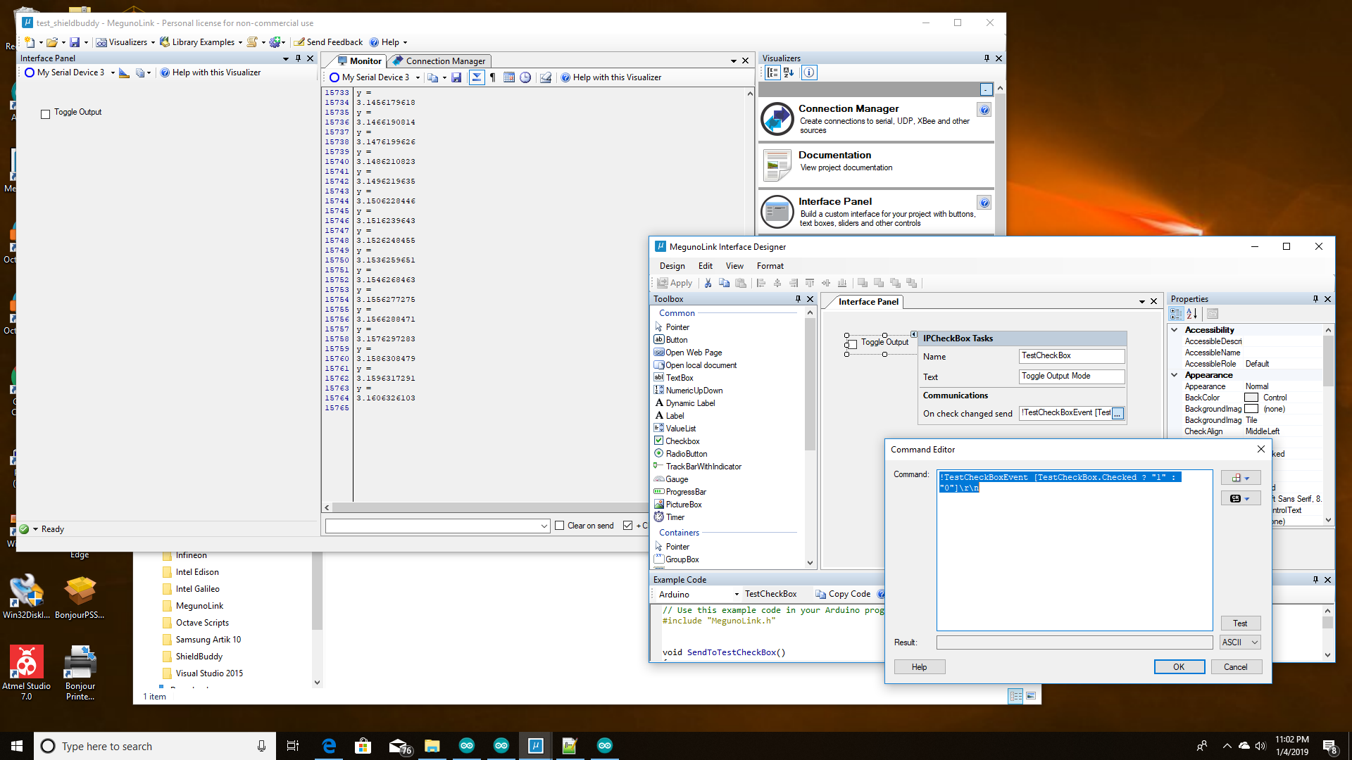

I'm trying to use Megunolink with a multicore processor called the Hitex ShieldBuddy. This Arduino board uses the three core Infineon processor running at 200 Mhz. I made a simple sketch and *.mlx file to study how to transfer commands and data between the cores. I use core0 to handle the slow serial port operations while the time critical number crunching is on core 1. The files are pasted below. For some reason I couldn't attach the *.mlx file but I did attach a screen shot of the interface.
Previously you mentioned that I could add a function argument to tell the Megunolink code to use SerialASC instead of the Serial which is more common for typical Arduino boards such as the Due, Uno etc. The fix was to use declaration statements such as,
TimePlot WaterLevelPlot("Water Levels",SerialASC);
where the serial port to use is explicitly stated. This worked great but I have now moved on to trying to use a check box to control events in core 1. I place shared variables in the LMU of the processor which I'm told gives fast access to any of the three cores. I am able to change the variable "y" (see attached *.ino for definition of "y") in core1 and send it across the serial port to the host using core 0. What I'm having trouble with is using a check box to change how "y" is evaluated in core 1. The function Cmd_TestCheckBoxEvent(CommandParameter &Parameters) is not being called when I toggle the check box. I was hoping you could give me some pointers on how to get this to work. I think I set up the SerialCommandHandler properly but it might not be using the SerialASC port. Thanks in advance for any help you can provide.

Screen shot showing check box setup
Screenshot (1).png (382.29 KiB) Viewed 13506 times

I took a look at the SetParameters example to see if I could get that to work. Turns our that I can use:
CommandHandler<> SerialCommandHandler(SerialASC);
to get this example to work. Not sure why this works, I'm not much of a C++ programmer ... at all. Maybe you could give me some insite into what's going on?

Yeah its in two places because we have to install it first to be able to copy it to a useful location for the user. If its not causing any harm its safe to leave both.
Yep the reason that works is because you can add arguments to customize it a little. Pretty lucky you discovered it ;)
