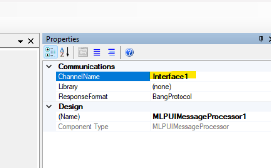

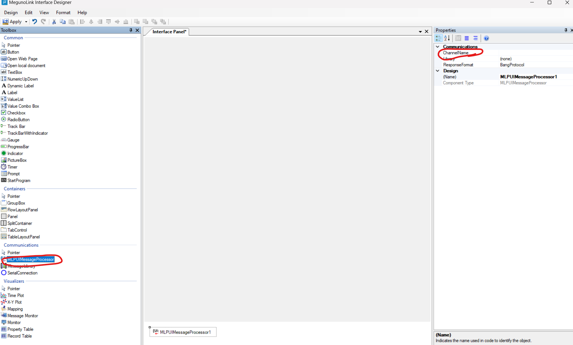

Im told it could also happen if you have multiple interface panels and you arent using channels to separate out the data. For example if you have two interface panels each with a separate text box when you send the command to the second text box the first interface panel will complain that it doesnt have the control present. To fix this you need to use channels which can be defined by adding a MLPUIMessageProcessor to the interface and setting a channel name.
See this screenshot
Define the channel
Then when you create your interface panel in arduino you would do something like
InterfacePanel myPanel1("Interface1");
InterfacePanel myPanel2("Interface2");
Now when you send messages to update controls they only go to the specific panel.
