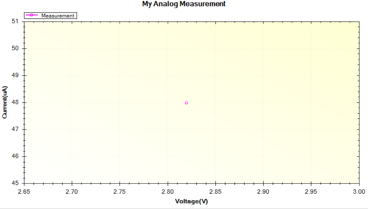

Hi, when you say not working. Can you describe in what way? It builds fine for me and seems to send messages.
I get
{XYPLOT|SET|title=My Analog Measurement}
{XYPLOT|SET|x-label=Voltage(V)}
{XYPLOT|SET|y-label=Current(uA)}
{XYPLOT|STYLE|Measurement:ms_2}
{XYPLOT|DATA|Measurement|2.82|47.97}
When I manually set adc1 to 25000, and adc2 to 15000.
What is it doing for you?
its also plotting fine. See the attached picture.

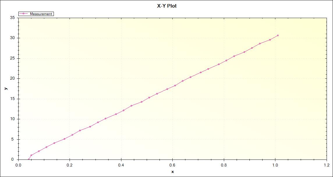

Hi, So I tried your version of the code and I got the same graph as you. The values are accurate.
So I tried my old code again (using the 16 bit ADC and its library). The plotting didn't work. I'll try to explain the situation as clearly as possible.
I have an analog circuit that sources current to a resistor in micro amperes (range 0-30uA for 0-150 PWM value) (at rate of 1uA/sec). I'm using my Arduino Uno and a 16 bit ADC (ADS1115 mentioned before) to source the current in steps using PWM signalling. The ADS1115 is interfaced to UNO over I2C and it senses the voltage across this load resistor and also senses the current going through this resistor on a different channel (ADS1115 has 4 channels). The for() loop I have in the code is for stepping up the current with the PWM every time.
With just Arduino's serial monitor I can send 1 specific PWM value to the circuit and I receive the sensed voltage value and current value just fine. I can verify my serial monitor readings using a source meter just fine.
When I try to use the Megunolink to plot all these values in real time (about 30 pairs of Voltage and current measurements), The X-Y plot is getting stuck on 1 random value in the 1st second and is not plotting any other values. A graph is attached.
I used the same program and disconnected the 16 bit ADC and used Arduino Uno's onboard 8 bit adc and the Meg's XY plot works just fine.The readings have errors compared to the source meter but at least the plot is working. Since my measurement values are very sensitive and I need high resolutions, I need to use 16 bit adc or may be even a 24 bit ADC. It seems to me that 16 bit ADC "analog read commands" are not working with the Megunolink. Please let me know what you think.
I appreciate the support.
Sai
Sai
- Attachments
- test.jpg (40.59 KiB) Viewed 41072 times

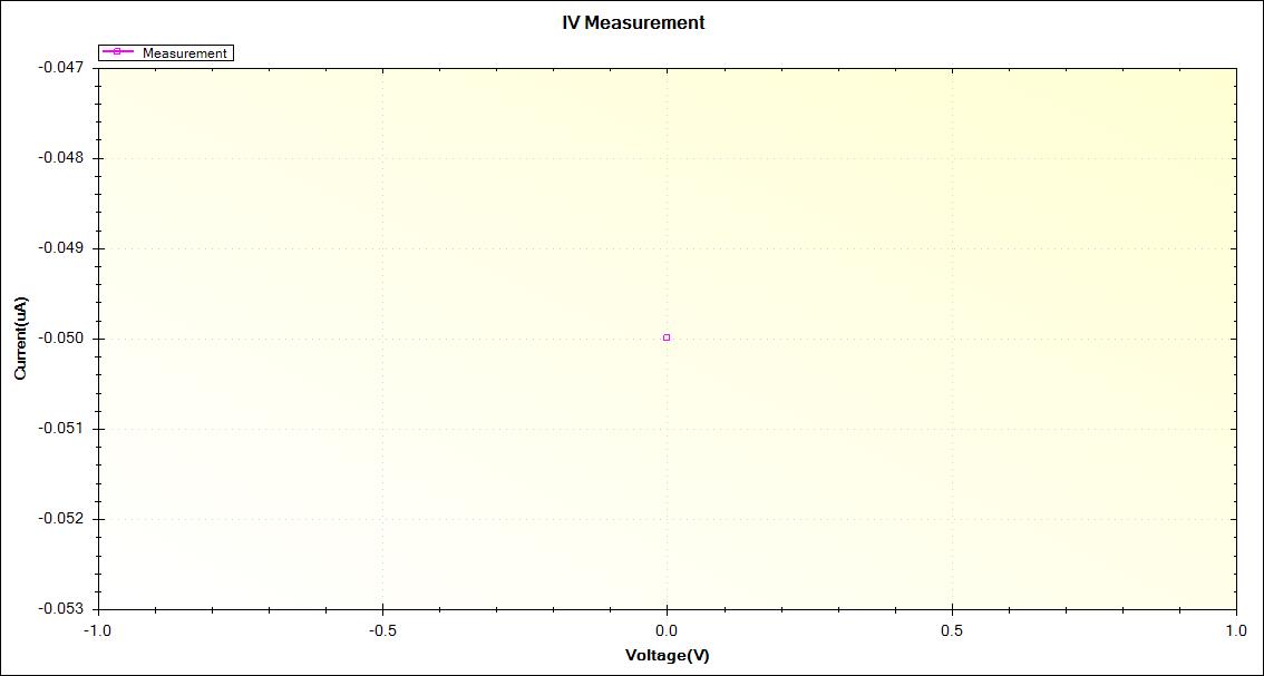

Here's a little more information. I've changed the code a little to send messages to the monitor instead of plotting (Still using the 16 bit ADC). The data from the Monitor visualizer is attached in a text file below. You can see the PWM step signal (the values 0,5,10 etc..it goes up to 150). The current value is supposed to start from 0 and increase in steps of 1 and go until 30 and the voltage should increase over time as well. Hope this helps.
{XYPLOT|SET|title=IV Measurement}
0
{MESSAGE|DATA|Voltage: -0.00}
{MESSAGE|DATA|Current: -0.05}

135
140
145
150
The code looks right. The only thing I can think of is a measurement problem. Maybe the adc chip needs more time between measurements or something. It sounded like you confirmed the adc numbers change when not in the automatic loop... Maybe the pwm delay isn't enough or something.
You can confirm megunolink is working by feeding in the i variable into your adc variables and making sure the 0 to 150 count plots properly. That confirms the plotting works then you just need to figure out what adc variables are not changing.
Let me know how you go
Also worth checking are your types. You're using int16 which is signed so -32k to +64k. Do you expected a signed number from the adc chip? Might need to change to uint16_t. Also you might need to cast your calculation so it generates the right types.

Hi Philip,
That was it. I wasn't using the ads1115.begin() command in my XY plotting program. I've initialized the 16 bit adc and it worked. I've attached a picture of my results.
Thanks for your help.
