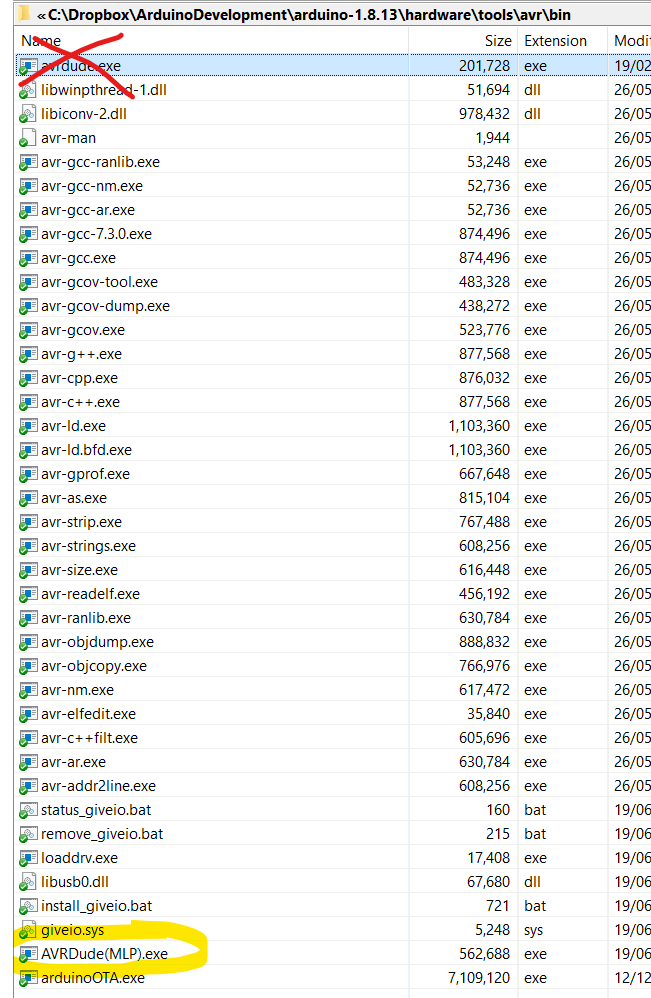

You can remove the wrapper by going to the hardware\tools\avr\bin folder, deleting the avrdude.exe we add and renaming the original back to avrdude.exe. See the picture below. Delete the file with the red cross and rename the highlighted one back to "avrdude.exe".

The file renamed AVRDude(MLP) is the original one supplied with the arduino ide. We rename it to this and copy in our one so that when you trigger programming MegunoLink is signaled so it can close the COM port automatically.
