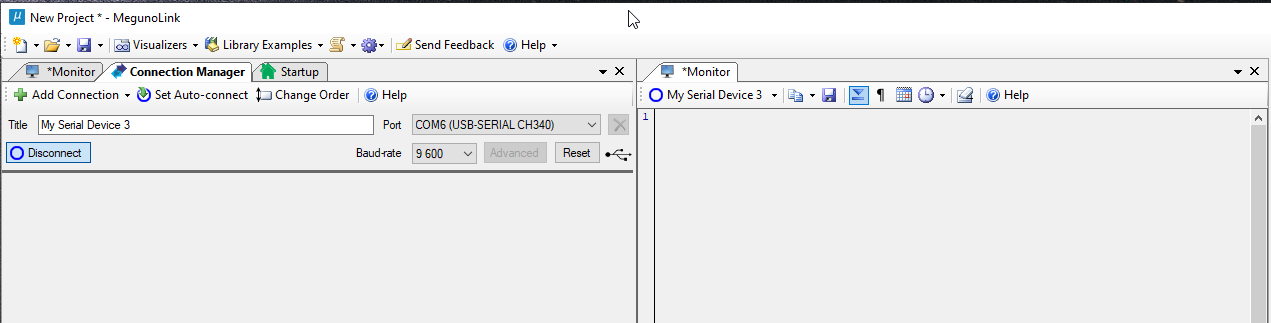

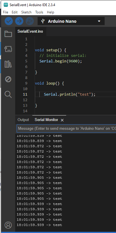

I just can't get the monitor to work. It worked before. But now nothing. However, the simple monitor of the Arduino IDE works with a test that I do. I don't forget to disconnect the monitor from the Arduino IDE and activate the one from MegunoLink. It seems to connect because the Connect button becomes round and the Disconnect label appears. But nothing appears in the monitor screen. Do you have any idea?

Hi, unfortunately there has been a driver released through windows update that has broken this. We are not sure why the Arduino IDE still works and continue to look into it. Best option for now is to delete the current driver and install the older one from somewhere like here:
https://learn.sparkfun.com/tutorials/ho ... rivers/all
You can find others complaining about the same issue.
https://answers.microsoft.com/en-us/win ... 06e34b2ed9
