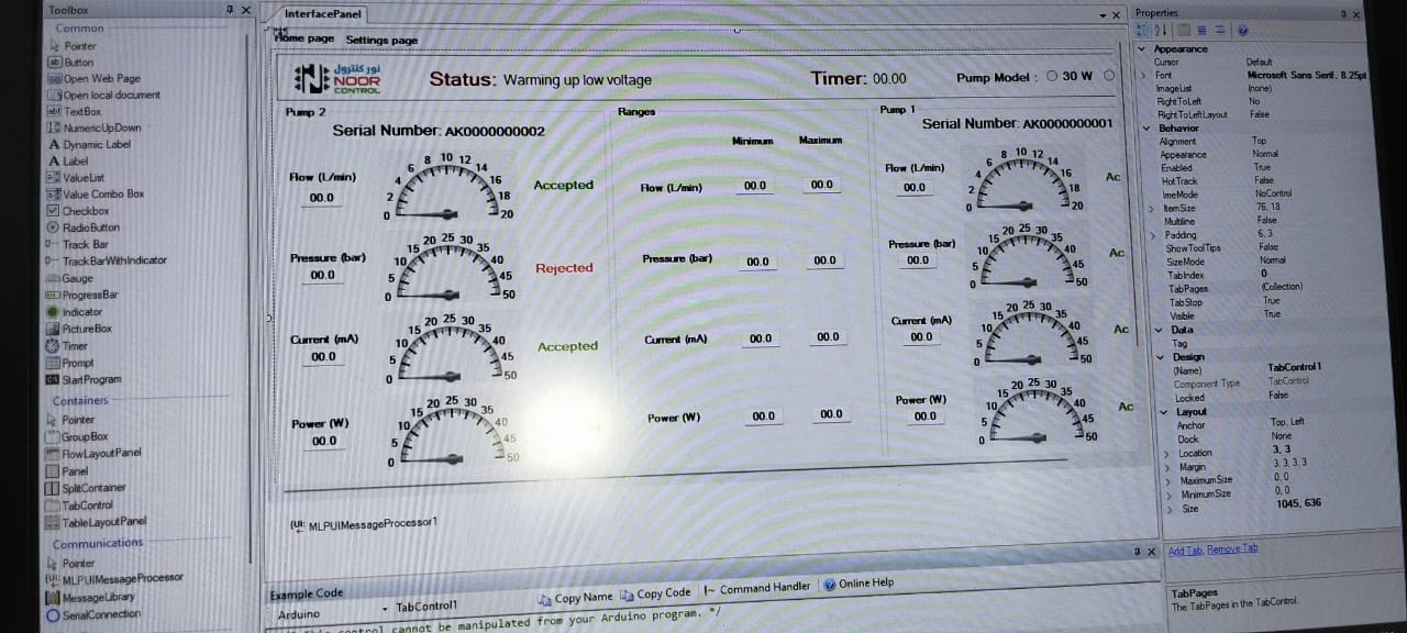

the project works with arduino uno, but doesn't work with arduino nano neither arduino mega pro
islam88elshaer
Joined: Sun Dec 07, 2025 7:36 pm
Mon Dec 08, 2025 8:34 am
I have an Interface panel using Gauge and textBox
using serial communication
My control board is arduino mega pro based
the Monitor doesn't receive any data from arduino mega pro USB cable, Therefore the Gauge and other controls doesn't respond
but by using exactly the same code on arduino Uno it works well, the monitor receives serial data and the Gauge responds.
Is there any additional configurations i should use with arduino mega pro ???
I attached my board photo and the progect photo
This is my code

Does your new board use a different serial chip by any chance and is it a CH340?
https://learn.microsoft.com/en-us/answe ... er-windows
They released a driver a while ago through windows update that stops it working. You can download the old one here
https://learn.sparkfun.com/tutorials/ho ... rivers/all
