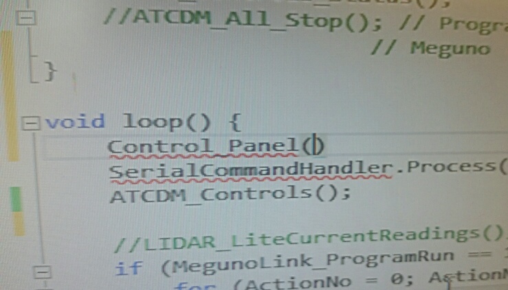

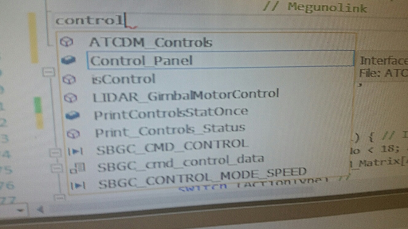

After declaring the InterfacePanel Control_Panel
I can use Control_Panel again in the Setup as noted here
But VS will not allow me to put Control_Panel in the loop as shown here:
