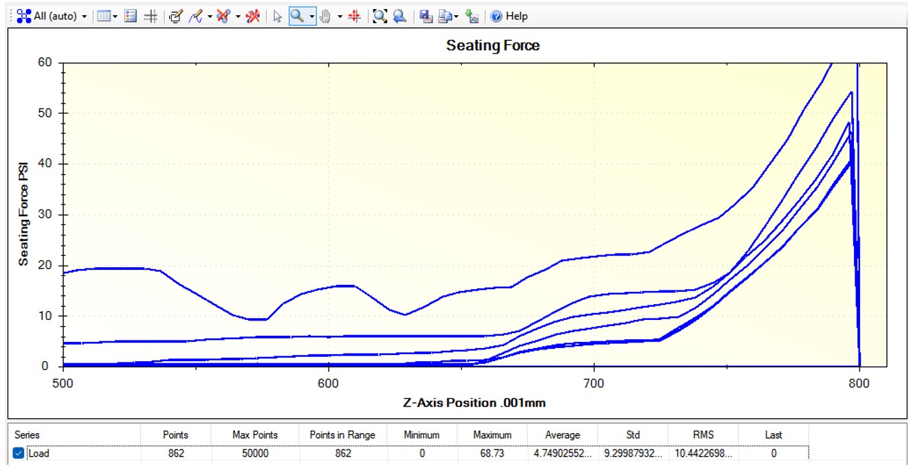

I'm new here, and a fairly novice Arduino programmer. However, using the guides, forums and help resources has gotten me pretty far over the past few days. However, I'm at the limit of my experience while trying to solve a problem. I have built a machine use to test part stress failures of 3D printed samples. I typically print 5 or 10 samples of each beam design, then load test them for their failure points. I've been able to successfully collect real time data using the TimePlot function, however I am trying to find a way to record data so that each collected sample, is drawn over top of the existing data. Ideally, each collected sample would be a different color.
Here is an example of what I'm trying to achieve.
is it possible to record data on the chart using the Fixed Time method, however at each sample, the time would revert to Zero and redraw then next sample data over the previous data sets.
Thank you in advance for your assistance. I'm looking forward to learning more.

Thank you. I was playing around with XY Plot just now and decided to do a test with the X axis reading the number of steps counted from my stepper pulse routine. It sort of works. At least I understand how I could use Timebase to achieve a similar result.philr wrote: Sun Sep 18, 2022 2:00 am Hi, I think you could do this by using the XY Plot (so send your own x values). And you would set it up so that for each plot you use a separate series name. An example for this on the timeplot can be found here
https://github.com/Megunolink/MLP/blob/ ... newave.ino
Note there is a cosine and a sine wave shown independently. XYPlot works the same. So you would need to generate a separate series name for each run you do and then use the same timebase (i.e seconds). Then they should plot on top of each other.
It seems like I'll have to create some sort of "For" statement to count each cycle press and then use that counter to create a series name and possibly alter the individual plotted series colors.
Any idea how I can eliminate that long diagonal line within the plot as it jumps from the high point back to the "Zero" point?
