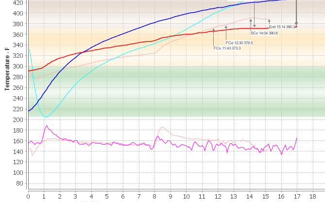

is it possible to limit the time plot screen to (Y-Axis 30 minutes) and show the minute in the bottom starting with zero?
see attached sample.
thanks
Robert
chart .jpg (86.35 KiB) Viewed 28762 times

Hi Robert, could you use xy-plot, specifiy the xaxis limits then send the x-axis values as minutes calculated by the arduino?

I finally figured it out.. thanks Phil that works.
